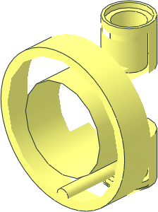

Subfile structure modified to be reused with 65766.dat
made the following comment.
2023-11-08 17:47:53
Maybe this could be reworked to use hi-res on the outer ring?
Jens Brühl [jb70]
Part Author
2023-11-09 22:31:19
Used Hi Res Primitives for outer ring
posted a vote of Hold.
2023-11-12 16:54:14
Maybe you can get the inside of the outer ring to work too?
The added 48\4-4aring doesn't work.
Jens Brühl [jb70]
Part Author
2023-11-12 23:38:07
Fixed issues with gaps between faces and primitives on the inside.
Orion Pobursky [OrionP]
2024-03-23 00:59:43
Update ring primitives via script. This will not reset the vote status of the part.

Peter Blomberg [WUIt]
2025-10-23 23:12:29
Australian English required: Center should be Centre.
Jens Brühl [jb70]
Part Author
2025-10-24 17:10:41
Header Edits
Rene Rechthaler [Blechtaler]
2025-10-24 17:18:29
why the hi-res rin13?
1 16 0 0 -30 2 0 0 0 0 2 0 1 0 48\4-4rin13.dat
1 16 0 0 -30 1 0 0 0 0 1 0 1 0 4-4rin25.dat
1 16 0 0 -30 26 0 0 0 0 26 0 1 0 48\4-4aring.dat
2 normal res rings and the aring at the outside would result in slightly less quads (and rin prims are obsolete, both exist as normal res ring prim)
Jens Brühl [jb70]
Part Author
2025-10-26 15:38:54
Removed high res from ring13
